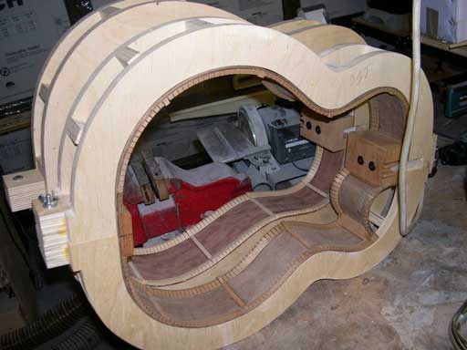

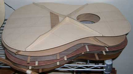

This is a stack of tops and backs, I carved the braces on all the backs, added the labels and on the top is the X brace for the Dread and the San Jose, I would have gone farther but it started raining and the shop's humidity shot up...

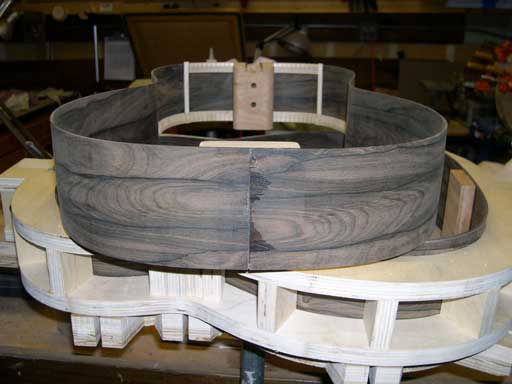

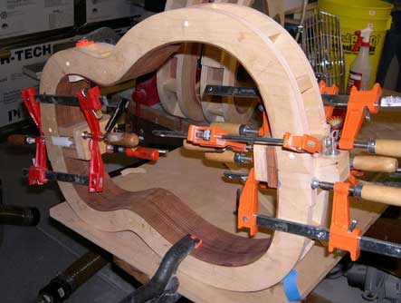

Bent and joined the Zircote that Lance sent me, glued on the end block and the mortise, ready for the sanding bowl and kerfing.

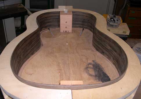

Bent and glued on the end block and the mortise on an all Koa guitar that's in the works (this is a show guitar that I'm doing something special with). If you look at the mortise you'll see a trick I do with my molds, that white thing is UHMW that is drilled and tapped like a neck tenon and bolts in it, the mold has a slot a little thinner than that tenon in the end of it.
When I'm build the guitar I can lock neck block in very straight, when your doing cutaway's it's a lifesaver.
I glued these up last week, and finished all the kerfing on saturday morning, they are ready for tops and backs. As soon as the rain stops I'll finish the tops.
Here's the Mis-Bent Zircote that caused me so much grief, it's going back in storage, I have plans for it after healdsburg...

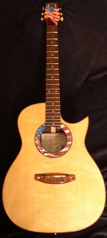

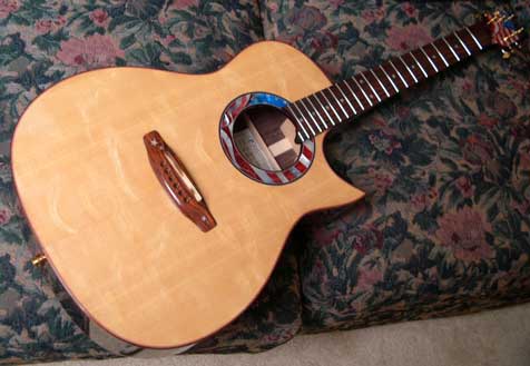

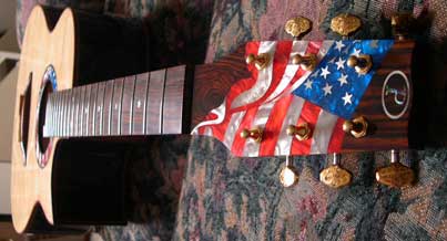

And finally I got this one ready for final setup, the bridge is not glued on yet and I still have to install the K&K system into it, then it's off to my friend for final setup, this is my first Healdsburg guitar:

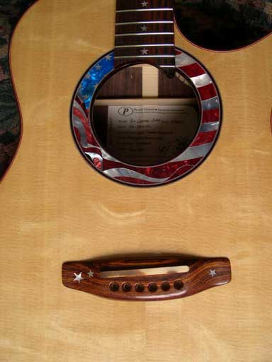

Very nice work, Paul. That's some ostentatious inlay. What is the material?
PostPosted: Mon Feb 28, 2005 3:43 pm
Posts: 886
MOTS........
Mother Of Toilet Seat for the red and blue and MOP for the white....
Jimmi Wingert did the inlay on that one, I'll post some quality detail pictures of it next week after it gets final setup. I shot it with KTM-9 and I'm very very happy with how it turned out, the gloss and depth are astounding, those pictures don't do it justice at all.

Nice work Paul. I have some confusion about the neck block registration system. Do you have to notch the sides prior to glueing them up? I would think otherwise there would be a gap below the mortise on the block.
PostPosted: Tue Mar 01, 2005 2:14 am
Posts: 886
Good question Paul, no I don't notch them at all. The block is exactly the size of the tenon, so I trim the sides and they but up against the tenon block lining them up with mortise edges.
I can take some pictures to show how it works, essentially I trim the sides right to the final fittings, because the tenon is there they register and line right up with the edge of the mortise and I just glue them up and I'm done.
It's hard to explain but I can adjust the upper bout sides by how much I trim them, because the tenon holds them apart at the right place I can dry fit until I'm %100 happy with it and then I just pull off the mortise (leaving the tenon block in place and glue it up.

Paul, Where are you getting your red and blue MOT. or did Jimmi supply it?

Michael the MOTS was Jimmi's idea not mine, I personally don't like it very much for inlay, it's too soft and doesn't like sanding very much and will try to avoid it for future projects when possible or treat it with Kid gloves.
